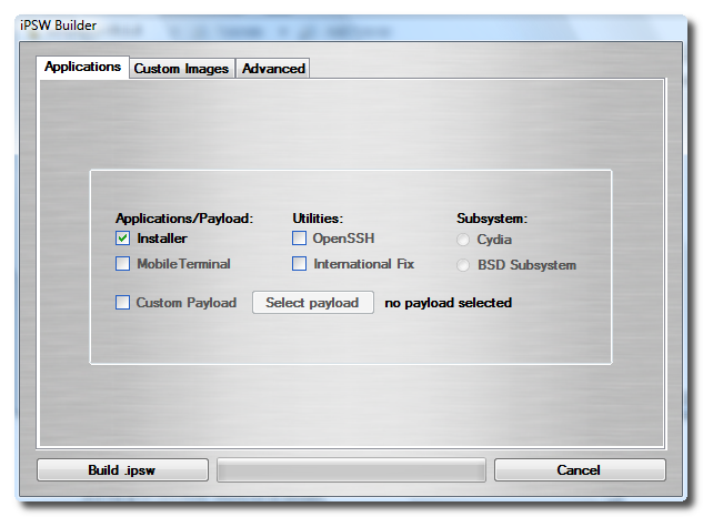

Step Fourteen
IPSW Builder
Step Fifteen
从应用软件中选择安装包. 注:WinPwn bata版 仅有Installer.app.
Step Sixteen
installer是用来在后面下载BootNeuter以解锁.注:当前的winpwnbata版还不能解锁
Step Seventeen
Build .ipsw

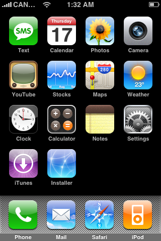

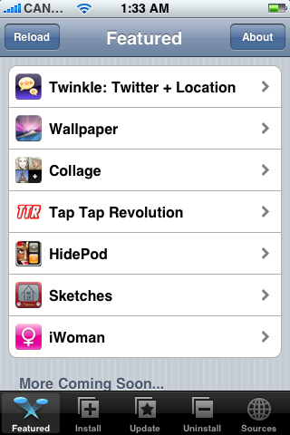

Step Twenty Five
通过installer安装 BSD SubSystemhere
Step Twenty Six
添加iClarified 源(http://installer.iClarified.com )here.
Step Twenty Seven
进入installer
Step Twenty Eight
选择 Install .

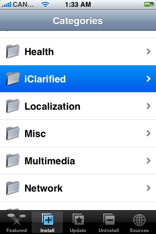

Step Twenty Nine
选择iClarified 分类.

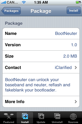

Step Thirty
选择BootNeuter .

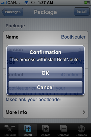

Step Thirty One
Install

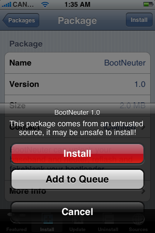

Step Thirty Two
点install
Step Thirty Three
点ok.

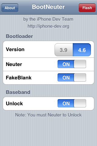

Step Thirty Four
运行iphone桌面上的BootNeuter
Step Thirty Five
如果iphone 3.9BL则选择3.9BL, Unlock, and Neuter.
如果iphone 4.6BL 则选择4.6BL, Neuter, Fakeblank, and Unlock.
确定选择,点flash
